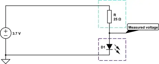

Now, let's think about a higher source voltage of 3.7V and a resistor of 25Ohm, which is perfect for the LED:
Let's play an intellectual game: Replace the LED by a potentiometer, and turn it. The voltage and current measured at the indicated node are drawn as blue line in my diagram above. (You can keep the LED and replace the resistor to get the violet/green curve, too)
The working point is where the blue line crosses the curve of the LED, since there current and voltage are the same for both games.
Now, the working point of the "bad" LED is about 3.16V and 23mA, which should still be fine.
