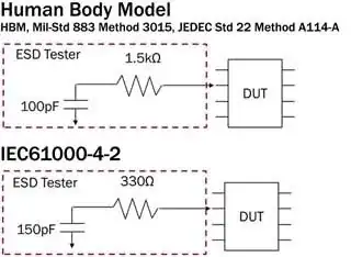

An interesting and related spin off subject is the well-known effect of a human body damaging electronic circuits by static discharge. The human body is modelled as a capacitance to earth of about 100 pF. This capacitance is charged up to several kV and the discharge path into the electronics under test is via a current limiting resistor.

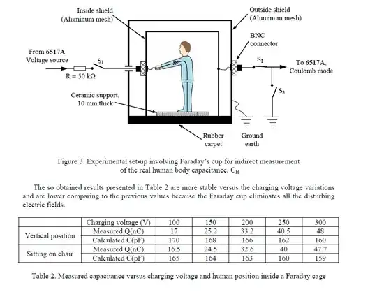

This document entitled "Measurements upon Human Body Capacitance: Theory and Experimental Setup" concludes that about 160 pF is a the human body capacitance in the following experiment: -
So if we connect to 220V 60Hz, 160 pF has an impedance of 16.6 Mohms (reactive) and would cause a reactive current of about 13.3 uA. I don't think capacitive effects are going to be very significant.
