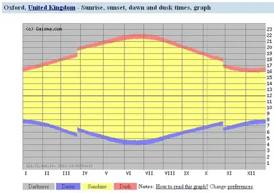

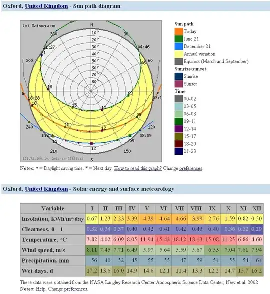

The utterly marvelous Gaisma site which provides lots of useful information about insolation (sunshine levels, rainfall, wind speed and much more) from thousands of sites worldwide, advise that the average daily sunshine hours month by month in Oxford England, January to December are:
Insolation, kWh/m²/day = "Sunshine hours"
  • Month / average sunshine hours per day
    Jan 0.67
    Feb 1.23
    Mar 2.23
    Apr 3.39
    May 4.39
    Jun 4.64
    Jul 4.66
    Aug 3.99
    Sep 2.76
    Oct 1.59
    Nov 0.82
    Dec 0.50
ie 4.66 in July and 0.5 in December.

Gaisma information for Oxford:
