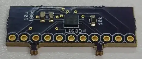

I made a breakout board for an LGA-16 part (LIS3DH) and two attempts at soldering failed with a solder bridge between two pads. Top view of the PCB:

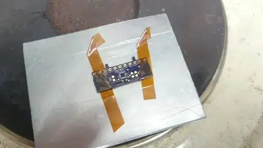

  • The board was heated with a hot plate until the solder paste reflowed, resulting in tinned pads without bridges: enter image description here
  • Flux gel (Edsyn FL22) was added and the part placed. I also added solder paste for the passives and the passives themselves and put the board on the hot plate again. When the solder began to melt again, I poked the chip with tweezers, but much too hard: it travelled a distance of about two pads. This was fortunate because it helped spread the excess solder from that one pin I mentioned before. I pushed it back into place and removed the board from the plate.
  • I could measure no shorts, and a few MOhms between all I/O pins and Vdd or ground. I have not actually tested if the board works, but it should. enter image description here There is still a visible blob of solder at pin 6 (right edge of the chip, camera end), which I could just push away with a toothpick. The chip is also reasonably flat on the board.
