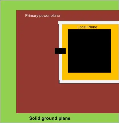

I would not split the ground plane, but I see no issues with creating a local plane for the device.
Find a ferrite that can handle the current required (they are usually available in the same package sizes as resistors), and put that down as a single power entry to the device. On the device side have a solid plane with this power and keep the ground plane solid. Route the high speed signals on layer 1 to maintain a constant reference to ground if possible (avoids routing over the split).
Logically, it is something like this:
Feeding power through a ferrite
It is not at all unusual to use this approach and provided you take care with the signals you care about (high speed ones) it should be successful.

  • Yes, I'm considering this method too, I'm trying to move all my signals routed to this chip to the top layer, which is referenced to the ground plane. – diverger Dec 16 '15 at 09:14
  • Is it suitable to put high-speed signal vias on the local plane? Because I can't totally avoid vias on high-speed line, but I just put them on the local power plane, there is no vias on the high speed line outside the local power plane. – diverger Dec 16 '15 at 09:39
