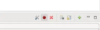

Now debug the project. In the bottom right hand corner there are some small tool and red button icons.
Click on the tool icon (spanners) and you will get the SWV config window
enter image description here In the SWV window click the 0 bit in ITM stimulus ports and the 0 port byte. confirm the sys clk frequency is correct (as entered earlier in debug configurations)
Finally click on the small red button/icon to actually start it tracing (this shows almost imperceptibly it is selected with a subtle outline when active) prints should now appear in the "SWV ITM Data Console" tab at the bottom of eclipse. You can CNTRL-A and CNTRL-C these to paste them into data files to forward to gnuplot etc.
