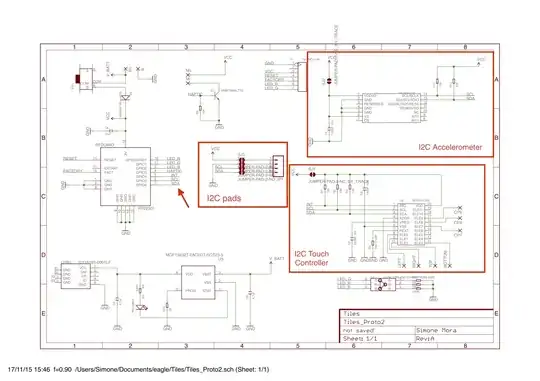

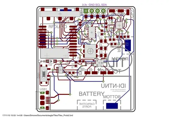

I built a simple sensor board connecting a RFDUINO to two I2C components. A ADXL345 accelerometer and a MPR121 Touch controller. The board also includes an RGB LED, vibration motor and Li-Po charger circuit.
The I2C bus seems not to be working, and I cannot read the register (using the wire library for Arduino) on the two I2C. If I connect a scope to the I2C lines (using some pads exposed on the PCB, see figure) I can see a 3.3v but no activity on both SCL and SDA lines.

Schematic PCB layout
    This isn't the solution but you don't need two sets of pull-up resistors if there is a set that will always be connected to VCC – Funkyguy Dec 14 '15 at 19:18
  • Thanks! yes, I figured that out after sending it for manufacturing. That should not disrupt the I2C bus though. – Simone Mora Dec 14 '15 at 19:28
    It can actually affect your I2C bus as those resistors aren't arbitrary. I'm not sure about the I2C bus specs for the RFduino but having too strong or too weak of pull-ups can render your I2C bus useless in any system. – Funkyguy Dec 14 '15 at 19:32
  • What kind of battery are you using? – DerStrom8 Dec 14 '15 at 19:33
    The datasheet recommends a 4.7k pullup on SDA, and is only required on SCL if there are multiple masters, or if the master has an open-drain output. You are using 10k pullups on SCL, SDA, and INT – DerStrom8 Dec 14 '15 at 19:36

  • Typo in the configuration? Shorted the resistors? What's the unpowered SDA/SCL to VCC resistance? For an Atmel in HW supported I2C mode that should be more than 500 Ohm, or it won't be able to pull it down quickly enough. Any less than 50 Ohm (short/near-short) and you will not even see much of a change on the voltage. And an I2C device stating in the datasheet it only needs pull-up on SCL in certain cases is not a fully qualified I2C device (and in my opinion should not be used as one at all, since the engineering dept. was out of heir depths) – Asmyldof Dec 14 '15 at 21:38
  • If I were you I would write a piece of test FW that scans all possible I2C addresses and toggles an LED (or does *something*) if you have a match. You can hunt down what addresses are on the bus very easily and match to the datasheet. This will help you differentiate between a hardware error (e.g. cold solder joint) FW error (e.g. you're not using i2c libraries correctly). I believe in arduino land you can just see if Wire.endTransmission() returns 0 for an address. If it does then the address is on the bus. – Doov Dec 14 '15 at 22:49
  • Really dumb question, but do you have the solder bead on the jumper pads?? – Scott Seidman Dec 14 '15 at 22:55
    Also, doesn't !CS on the accelerometer need to be pulled low? – Scott Seidman Dec 14 '15 at 22:57
  • While this probably isn't the problem in this case, excessive pull-up can prevent the I2C bus from working. More in [this post](http://electronics.stackexchange.com/a/68097/7036). – Nick Alexeev Dec 15 '15 at 02:04
From the ADXL345 datasheet:
The #CS pin should always be tied high to VDD I/O or be driven by an external controller because there is no default mode if the #CS pin is left unconnected.
Try to solder VCC manually to the IC if you have placed a pad that can be reached at all. Else, you'll probably need to find a more creative solution.
FRob
  • 588
  • Thanks, this is indeed a flaw in my design. Yet the second I2C device (touch controller) should work fine anyway or leaving the #CS disconnected could disrupt the I2C bus for all the devices? – Simone Mora Dec 15 '15 at 17:14
  • @SimoneMora There is another problem then. Double check all the connections and make sure you get a working waveform using your scope. – FRob Dec 15 '15 at 17:45
  • @SimoneMora One I2C slave device can bring down the entire bus and prevent other slave devices from communication. Here's a [remotely related answer involving ADXL345](http://electronics.stackexchange.com/a/34586/7036). One way to test this is to remove the ADXL345 chip, and try to talk to the other I2C slaves. If you can talk to them, then ADXL345 was the culprit (in one way or another). On a related note, judging from your comments, you haven't read the [I2C bus specification](http://www.nxp.com/documents/user_manual/UM10204.pdf) yet. Please read it (at least skim through it). – Nick Alexeev Dec 15 '15 at 18:35
  • @NickAlexeev Thanks! I read the I2C specs and realised that the amplitude of the signals (2.4V) I get on SCL/SDA is ok. I also discovered that I left both the CS and SDO/ALT ADDRESS unconnected. I tried to wire them up to VDD (as in the datasheet, should I add a resistor too?) and scan for I2C address from RFDUINO but still cannot see the accelerometer or any other devices on the bus; but I cannot trust my soldering work because the pins are very small (QFN package). I wish I could try removing the accelerometer but I don't have proper equipments. – Simone Mora Dec 17 '15 at 15:02
