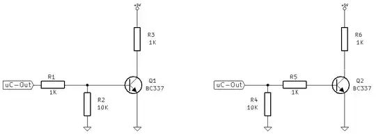

  • Already trying this schema. Using transistor as a switch. And fail to work properly is what i got. Btw, in experiment using a led as a test it is work. So there is another factor that make it failed, maybe resistance. – irawan Dec 18 '17 at 08:16
