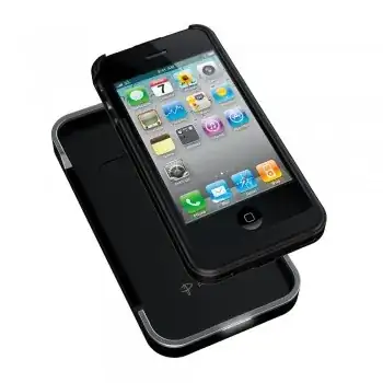

There's a variety of snap-on wireless charging solutions on the market. For example, this one includes a charging mat and a plastic case that is put onto iPhone.
I suppose the winding is in the middle of the case back and occupies a rather huge area. For comparison, MIFARE Ultralight smart cards are size of a credit card and wires can be seen if the card is lit through with a bright light source - they run right along the card perimeter. This question contains a scan of a stripped card.
Now when the phone is placed onto the mat the charging system air core transformer completes and I suppose the magnetic field is rather strong there. How does that field not induce currents in the phone circuits and not interfere with the phone functioning?
I mean, if the phone was shipped with inductive charging the manufacturer would have to design the phone appropriately from the beginning. Yet the described system is shipped by a third party and clearly it was designed separately.
How do such third party snap-on systems not interfere with the device functioning?

  • Now charging your iPhone 4 is as simple as setting it down! Complete solutions are pre-pack bundles pairing a Powermat one position charging mat and a receiver to provide a seamless upgrade to wireless charging. Charge your iPhone 4 with the Powermat 1Xi and Receiver Case for iPhone 4.
AND
  • Wireless Receiver Door for iPhone 4
    The wireless Powermat Receiver case for iPhone 4 allows your iPhone 4 to charge wirelessly on any Powermat wireless charging mat Powermat Receiver Case seamlessly upgrades your iPhone 4 to wireless charging
    One time replacement of your phone's case with a slim, sleek, formfitting design that mirrors your iPhone's original design Simply place on any Powermat Mat to charge wirelessly, no plugging and unplugging
Image: Phone held above charging base.
The key point to note there is "and a receiver" - implemented in this case in the replacement case unit.

Image: Phone with "receiver" attached.

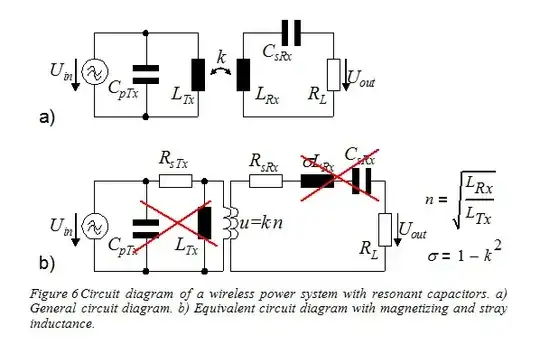

Resonant Coupling
  • by: Eberhard Waffenschmidt, Philips Research
    From the beginning of inductive power transmission, resonant circuits are used to enhance the inductive power transmission. Already Nicola Tesla used resonances in his first experiments about inductive power transmission more than hundred years ago. Especially for systems with a low coupling factor, a resonant receiver can improve the power transfer. Resonant power transmission is a special, but widely used method of inductive power transmission and is limited by the same constraints of magnetic fields emissions and efficiency.
    To understand the effect, it can be compared to mechanical resonances. Consider a string tuned to a certain tone as mechanical resonator. Even a far away and low level sound generator can excite the string to vibration, if the tone pitch is matched.
    Here, the resonator in the receiver consists of the receiver inductance and a capacitor. Also the transmitter can have a resonator. The general arrangement is illustrated in Figure 6a. The transmitter and receiver coils LTx and LRx can be considered as weakly coupled transformer. For this, an equivalent circuit diagram consisting of magnetizing and stray inductance can be derived, as shown in 6b. In this diagram, also the resistances of the windings are shown. The diagram shows clearly, that the resonant capacitors cancel out the stray inductance in the receiver and the magnetizing inductance in the transmitter. Now, the only remaining limit for the power transmission is the winding resistances of the coils, which impedance is one or two orders of magnitude lower than that of the inductances. Therefore, for a given generator source, much more power can be received.

  • The diagram shows clearly, that the resonant capacitors... which impedance is one or two orders of magnitude lower ... Therefore, for a given generator source, much more power can be received.
    As shown in the diagram - the capacitors tune out the parts of the ircuit which are high impedance so you can get big voltages at the selected frequency when you use resonance. Without resonance you may get 100 times less current flow. 100 is a lot.
