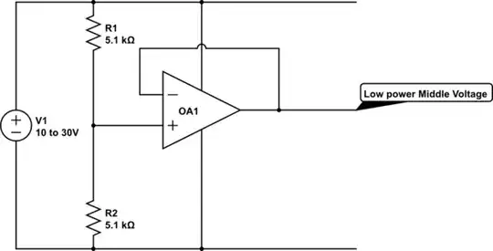

So now you need to "amplify the middle point":
simulate this circuit
The op-amp wants to keep the voltage on its negative input the same as the positive input when you use it with negative feedback like in this setup. So, it will "mimic" the voltage on the middle of the resistors on its output. Unfortunately the op-amp is not very strong either.
This will only give you about 5mA to 10mA of "middle voltage current capability", which is still super little.

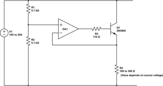

So, how do we fix that? Add transistors:
In this design the transistor is set up as an emitter follower inside the feedback loop, which amplifies the current the op-amp can supply. Unfortunately this is only able to source current from the positive rail, so to allow the balance when you want to give or take current, you need the pull-down resistor.
This does mean that a constant 50mA will flow through the resistor and transistor at all times, which means both will get hot. This is in many ways not a perfect solution, but it's the next step.
