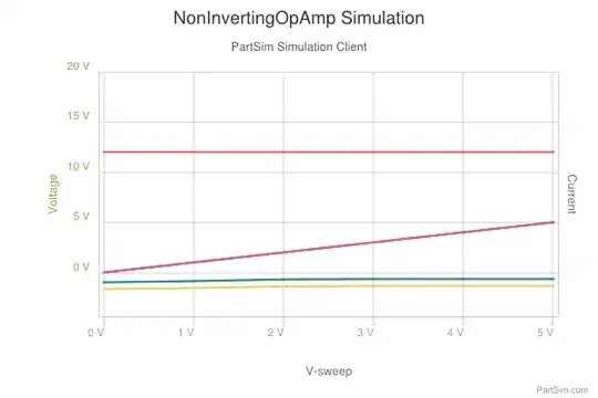

Here is the simulation using the LF412. This seems very wrong:
LF412 Simulation
Vmax is orange
Vout is blue
Vin (the V+ input) is purple
alsoVin (the V- input) is yellow

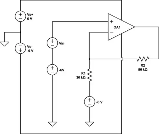

Now let's re-draw the circuit and pick a new ground point such that you get a symmetric supply:
simulate this circuit
In your graph, you are picking \$V_{in} \in [0V, 5V]\$. This corresponds to \$V_{+} \in [-6V, -1V]\$. Looking at figure 5 of the LF412's datasheet, the minimum common mode voltage allowed for a -6V negative supply is about -2.9V, or in the unshifted reference you're using of 3.1V.

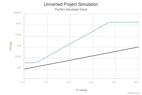

Here's the simulation results with the fixed model (\$V_{out}\$ is blue, \$V_{+}\$ is black):
Interestingly the output doesn't quite line up with theory; that's because I simply assumed that because figure 5 of the datasheet doesn't show the negative supply voltage vs. common mode voltage range it won't work below that. Instead, it is simply unspecified. The model just happens to work below that, though I don't know which behavior you'll actually get in real life.

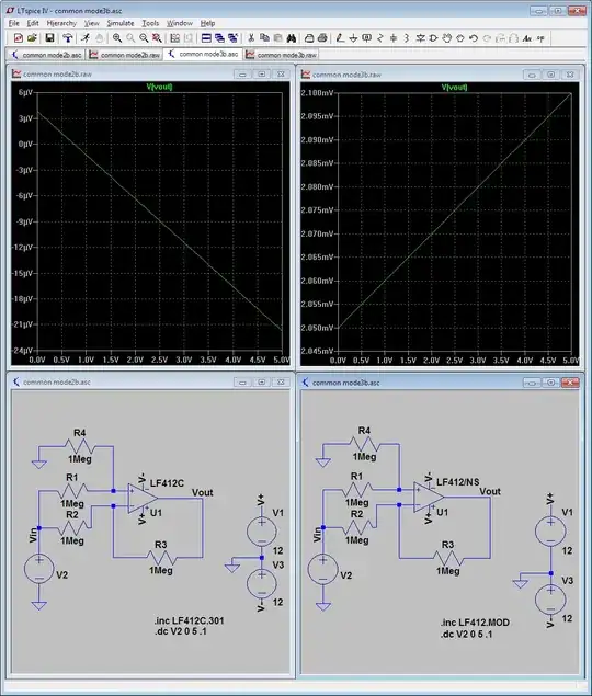

I think I figured out what the addition is in the NS model. LF412 (incl. N variant) datasheet has a typical CMRR of 100dB. That means for a 5V common mode voltage a change in the output of 50uV. With the 412NS model we get exactly that "common mode effect". With the 412C model it's some seemingly random stuff/value.
There is however not simulation of the common-mode input range in the latter either, it seems.
