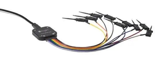

Not sure if this matches your definition of low-cost but the Saleae Logic Pod is around $150. Eight channels and works well for decoding SPI and I2C. Haven't tried any other protocols.
The software is OK but the interface seems a little strange compared to an oscilloscope or real logic analyzer. On the website there was mention of an API definition so that you could write your software interface or scripted data collection. I haven't had time to look into this any further.
Not sure if the levels go negative for true RS232 work.

  • I haven't seen real RS232 in years, thankfully. The API idea appeals – Toby Jaffey Mar 25 '10 at 00:47
    Do you mean the Saleae Logic Pod? http://www.saleae.com/logic/ –  Jun 15 '10 at 17:54
  • That's the one. Sorry about the misspelling. Since March I have used the pod quite a bit to debug a uSD library. The device is worth the money but the software interface is awkward. I am not sure if other devices in the price range are any better. If I used this tool a lot I would look into writing my own interface. – jluciani Jun 16 '10 at 02:30
  • I use it almost daily for working with half-duplex RS-485. Personally, I like the interface compared to others in the price range. A different scope I've used is the USBee line of devices, but they're pricier for similar functionality. FWIW, they've migrated to more of a Saleae interface recently. –  Jun 16 '10 at 15:06
  • The device is *not* RS232 level compatible. It uses 3.3V internally, but is 5V compatible so it'll work with most digital circuits. Not sure how far down it can go though, it would be nice to use it with 2.5V or even 1.8V stuff too. – Trygve Laugstøl Mar 21 '11 at 14:26
  • Sigrok supports the Saleae logic, if you want to try different software. It's a bit of work to get going, though. http://sigrok.org/wiki/Saleae_Logic – Connor Wolf Nov 25 '11 at 05:33
  • An excellent device. Pays for itself in no time. Does CAN too. – Rocketmagnet Apr 11 '12 at 08:30

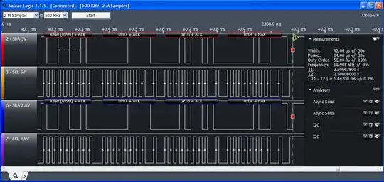

For a logic analyser, I highly recommend the Saleae Logic.
Saleae Logic
There are two versions with 8 or 16 input channels. It can sample upto 24MHz or 50MHz depending on which one you buy. And the software can interpret the signals, allowing you to easily read I2C, SPI, CAN etc.
Saleae Logic Software
This has saved me, probably, hundreds of hours of my life. They aren't that expensive, especially considering how much time they save you. And the software works on Windows, Mac and Linux. Data can be exported to a a file, and there's even an API so you can write your own software for it if you really want.
