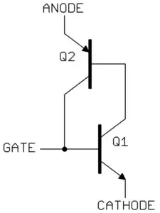

Here is a simple way to think of how a SCR works:
A SCR isn't just two transistors hooked up like this, but this isn't bad as a mental picture of how one operates. You can even build this and have it work like a SCR as long as you keep the currents low. Note that all current in this circuit ultimately flows thru one of the bases. These don't have much current capability in normal transistors. A SCR is a sandwich of P and N regions such that the "bases" are intended to handle the current.
Anyway, think about this circuit or even build it. Once current starts flowing in one transistor somehow, it turns on the other transistor, which keeps the first transistor on. Once on, this thing will stay on until there is too little current to keep it on.
