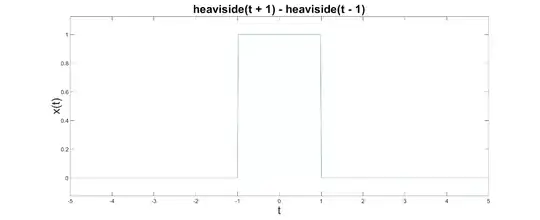

I'm interested in knowing: 1. Why the frequency content has a larger magnitude at low frequencies 2. Why the magnitude is zero at frequencies which are composed of multiples of the rectangular pulse's period
\$x(t)\$:
\$X(j\omega)\$:

The non-periodic example in your question produces a continuous spectrum but the nulls and the peaks still align with the examples above.
As for the low frequency being so high in the OP's example, it's because the pulse has significant DC content
