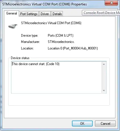

I am using CubeMX to generate project, chose Audio Device Class there, it created default library files. uVision complied without errors or warnings. I flashed my MCU and in device manager it looks like this: enter image description here
After my learning about CDC USB, I knew that I need to increase Stack_Size and Heap_Size in startup file. I tried it - nothing changes. I also found some advice to decrease HS_MAX_PACKET_SIZE - still no effect.
Well, the questions are:
  1. Why is it under COM port? Even if some configurations are not correct, shouldn't it be under sound devices?
  2. What is wrong? How to make it work? It would be good just to make it recognized as audio device at least, nothing special.
The error under the device is just generic "This device cannot start" error.

Check USBD_malloc() in the USBD_AUDIO_Init() allocates requested memory. USBD_AUDIO_HandleTypeDef contains:
buffer[AUDIO_TOTAL_BUF_SIZE]
AUDIO_TOTAL_BUF_SIZE = AUDIO_OUT_PACKET * AUDIO_OUT_PACKET_NUM
AUDIO_OUT_PACKET_NUM = 80
AUDIO_OUT_PACKET = (22100 * 2 * 2)/1000
So total memory allocation size is about 7100 bytes. I set heap size in CubeMx project 10KB (2800h). After that windows (I use win10) recognizes stm32f4 as audio device.
Bence Kaulics
  • 6,353
  • 60
rawaaw
In device manager, right click on virtual COM port device and uninstall device. Check delete the driver software for this device. Reset the device. Now Windows should install driver for usb audio device class.
davluc
You shall change the PID of the new device. Or your audio device will have the same PID as the previous CDC device. The system will recognize those two devices as the same then.
