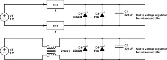

I inherited the top circuit from a previous designer on my robotics team. The circuit uses two ferrite beads, a zener, a TVS and a capacitor to filter incoming power. The incoming power comes from batteries. Along with the digital circuitry the batteries have large motors connected to them making for a very noisy environment. My understanding is that with the help of the ferrite beads the zener and TVS suppress any spikes. Then the large capacitor holds up any droops. This circuit has worked well so far.
My question is whether replacing the ferrite beads with a common mode choke improve the filtering or if it's not broken don't fix it?
(I just used generic components to give the general circuit layout, the top is the current circuit and the bottom is my proposed change)
Additional info The circuitry is going into a robot. The robot is made out of extruded aluminum (not grounded) and the whole thing is clad in clear acrylic. The whole thing is powered by a 24V 8 cell lithium iron phosphate 20Ah 10C battery. The digital circuitry draws about 1A. The motors are two wheel chair motors. The motors are rated at 60A max but they are never driven that hard, usually around 50% or less. The motors are driven by Vex Victor H bridge motor controllers.

    http://www.murata.com/~/media/webrenewal/products/emc/emifil/knowhow/26to30.ashx may help. The ferrite beads work for differential mode noise as a series inductor, while the common mode choke works for common mode noise. – michaelyoyo Nov 26 '15 at 02:37
  • The sort of spikes that may be expected on a system like this will not be at all dealt with by ferrite beads so, your analysis is wrong of the threats that the zener and TVS are expecting to deal with. More likely the cable loom feeding them is going to be part of the solution. – Andy aka Nov 26 '15 at 08:55
    @Andyaka What would you recommend for filtering instead? – vini_i Nov 26 '15 at 12:04
    A decent definition of what threats are coming down the line is the only way to answer that. – Andy aka Nov 26 '15 at 12:26

It depends on the environment of your board. Let's call the negative pole of your supply voltage GND. For example in a car, the whole chassis is GND, but you are connected only at your supply pins, not directly on the chassis. Your board has an parasitic capacitance against chassis, so noisy HF current will flow there. If you have a case like this, the common mode choke will help, because the HF current will need through your VCC and your GND supply line.
If your board creates some kind of other HF-Noise internal, a switching regulator, or some kind of CPU or memory interface, most of the current flows from the high-speed signal to your internal GND (High speed switching). The commom mode choke won't prevent the noise from getting out of your design, because there is a current flowing in and a current flowing out the same time. In this case a Ferrite Bead would be an better choice.
I suggest you to keep the ferrites for some reasons. Common Mode problems can be eliminated, if your signals on the board have an greater capacitance to your internal GND as against the chassis or some other external devices. In addition to that, ferrites are cheaper most time. I don't know your specification, however, i work in automotive industry, i would take the ferrites.

Returning to the circuit you posted, my initial approach would be:
  • Not using a common-mode choke, as it is more indicated for capacitive coupling noises generated from outside of your system.
  • Applying dual LC filtering for both lines (power and GND return) or even better, a dual L pi filter. This is the most effective filter for KHz to low MHz noise. A big inductor (in the mH range) in series with each of the battery terminals will improve dramatically the noise entering the digital part of your circuit. Ferrite beads, on the contrary, are dissipative by its own nature and best suited for higher (dozens of MHz frequencies).
  • Substituting the standard zener & unidirectional TVS for a bidirectional rugged (high energy) TVS. The zener in your circuit can be kept, however, if your input regulator cannot withstand small peaks of overvoltage.
  • Adding a pair of small ceramic capacitors in parallel with the bulk capacitor: for instance 1uF and 0.1uF MLCCs, rated conservatively (>100V). This will increase your filter effectiveness for higher frequencies (>1MHz).

The common mode choke and frrite don't necessarily contradict. Also therr are many different common mode chokes, for various currents and frequency ranges. In general, you must understand, what are you protecting from what. If you are reducing fonductive emissions caused by on board dc/dc, pick two chokes to cover the range between 0.5MHz to 50MHz and from 500MHz to 5GHz. Latter may very well appear a common mode ferrite. By the way, you may need capacitors to create effective filter around the chokes. And of course pay attention to the ground policy of your system.
A common mode choke is useful for reducing noise that is "common mode" - obviously, in other words - similar noise present on both lines. This may be usefull for filtering out high frequency noise like an RF signal coming from a near by radio transmitter. Systems with an ungrounded metal housing might benifit if there is suspected HF noise being induced (inductively or capacitively) to both isolated power lines, (for example if the housing had other noisey electrical systems connected to it.)
Single ferrite beads (as shown) can reduce sharp current spikes if they are sized correctly. Generally the smaller beads filter higher frequencies (though the ferrite material matters too). To filter lower freqency spikes you generally need larger (thicker beads). If the beads being used do not seem adaquate, change to a larger size, or you might use large value inductors instead, (similar large inductors are often used in power lines going to hifi audio equipment - you would also need to verify the current handling capabilities of the inductors if used).
Also, adding a small value ceramic capacitor in parellel with the large value capacitor may help filter some additional high frequency noise. Large electrolytic capacitors may not filter high frequency noise so well.
Lastly, ferrites work best when there is some relative noise current flowing. The noise currents induce magnetic fields that the ferrite material dissapates as heat.
So assuming your noise is not common mode the use of the two beads (or inductors) seems the better choice.
Nedd
  • 7,939
The TVS devices takes some time to turn on during which the input voltage spikes might reach the micro end. Ferrite beads can help in protecting the device in this regard while common mode choke offers only minimal impedence (leakage inductance) for the differential surge event. If your require common mode attenuation, i would suggest using a hybrid common mode choke in this case.
