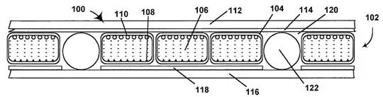

Here is a cross section from a patent USPTO 6987603 B2: enter image description here
122 = spacer ball to maintain separation of front panel from TFT
104 = the flexible micro-encapsulation - in it's crushed down state in a display
110 = a white/black particle
108 = a black/white particle
118 = TFT electrode
114 = the common (aka Vcom) ITO electrode
