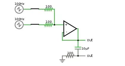

If one passes a square wave or sawtooth wave through a high-pass filter whose cutoff frequency is far above the fundamental of the original wave, the output will either be an alternating sequence of positive and negative pulses (for a square wave), or else will only have pulses in one direction (for a sawtooth).
See this circuit on Falstad:
Schematic
Measurements:
Squarewave in Sawtooth in (falling) Sawtooth in (rising)
