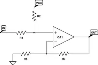

  1. Use a non-inverting circuit. Offset adjustment can be done like this:
simulate this circuit
However, I'm worried about connecting multiple opamps together. In the above circuit, R2 changes the input signal; will multiple opamps with inputs connected together affect each other in this case?
  1. Simulate the whole circuit and optimize resistor values so all the opamps will have a correct gain. This method would produce a lot of optimization goals which would be difficult to achieve. How stable a circuit built like this would be?

    If V1 is an ideal voltage source, which a simulator source will be, there is no interaction between the circuits. So I don't see exactly what you're asking. – WhatRoughBeast Nov 21 '15 at 20:12
  • It's not a simulator source — it's a voltage drop generated on a low-value resistor (50 Ω). Also, simulation results (specifically OA1 gain) seem to change when the second circuit is disconnected. – Vladislav Ivanov Nov 21 '15 at 20:16
    OK, then edit your schematic to add a 50-ohm resistor in series with the voltage. If you're going to ask a question based on an erroneous description, you're going to confuse people. – WhatRoughBeast Nov 21 '15 at 20:19
  • I have edited the schematic, sorry for the confusion. – Vladislav Ivanov Nov 21 '15 at 20:25
The simplest way to eliminate your problem is to reduce the effective impedance of the source, and a voltage follower will do nicely
The choice of buffer op amp is left to you, depending on the frequency response you need.
