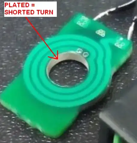

I am trying to make a planar inductor (made from the tracks of the PCB, and surrounded by a 2 part a ferrite core). According to the datasheet of the ferrite core, the AL value is 1700nH, which means that with 12 turns around the core, I should get 12x12x1.7 = 244uH.
The problem
However, when I measure the inductance on my LC meter, it reads only 1.8uH. What's stranger is that if I create an inductor with the same core, but using stranded wire, and only 10 turns, I get 46uH!
I measured the resistance of the PCB tracks, and it's 0.25R, just as it should be, so I don't think there's a short in there.
Planar vs wound inductor
Planar inductor layers
My questions
What's going on? Is the AL value not sufficient for calculating inductance? How could it be that fewer turns gives a much higher inductance? Is the stranded wire massively better than PCB trace?

  • 1 shorted turn will do this. Please show all the layers seperately - I can see what technique you have used and it looks sound so the devil must be in the detail. I've made them myself and not had a problem so there isn't something innately flaky about this methodology. How does light blue connect to dark blue? – Andy aka Nov 20 '15 at 18:34

  • How tight are the core halves fitting? Is it possible that stray glass fibre or other mechanical problems are introducing air gaps? (And a much smaller airgap in the hand-wound one?) NB Sticky tape won't do it... there are usually strong spring clips or similar to ensure consistent clamping. –  Nov 20 '15 at 20:22
    the slightest gap between mating faces of the core will collapse the inductance value. Are you sure the faces are meeting, and not being fouled by the PCB? – Neil_UK Nov 20 '15 at 20:22
    Yeah they look cool and exactly how I did it on a regular transformer. Shorted turn is my guess. – Andy aka Nov 20 '15 at 20:23
    @Andy : apropos of which : that white stuff inside the hole isn't through-hole plating, I hope! –  Nov 20 '15 at 20:24

  • @BrianDrummond - I've tried pressing the halves tightly together with my fingers. The PCB is 1.6mm thick, and the cores have about 3.5mm space inside. The inside of the hole is plated, but that plating isn't connected to the coil (I already checked that). – Rocketmagnet Nov 20 '15 at 20:35
  • @Andyaka - If a shorted turn is the problem, then why is 10 turns of stranded wire producing only 46uH, when I calculate that it should produce 170uH. Am I calculating it wrong? – Rocketmagnet Nov 20 '15 at 20:37

    If the inside of the hole is plated, there's your shorted turn. Get the scalpel out! Doesn't matter if it's electrically isolated, it's still tightly coupled via the core. So you're measuring the leakage inductance at 1.8 uH. –  Nov 20 '15 at 20:58
    I think @BrianDrummond nailed it. Whether internal holes are plated or not seems to be a bit of a crap shoot. Some use copper on either side of the edges as a marker for 'should be plated', but you have a definite gap there. All you need to do is to break the plating at one spot so it isn't a complete turn. – Spehro Pefhany Nov 20 '15 at 21:09

    @OlinLathrop - I removed the plating as Brian suggested, and measured 280uH. So I guess it is possible to get hundreds of uH in such a small inductor. – Rocketmagnet Nov 23 '15 at 10:11
Brian has nailed it. Good shout. @Brian please take this picture and make your own answer. I'll delete this answer as soon as: -

  • No, shorted turn was your suggestion in the first place. (Upvoted) And I'm expecting there'll still be some discrepancy as with the hand winding, (gap?) so we may not be quite done yet. –  Nov 20 '15 at 21:38
    @BrianDrummond You are a gentleman. Looking at the data sheet tells us that N97 material in that core size is indeed 1800nH for 1 turn so that's looking suspiciously significant. Using the wire should produce 180uH but it all depends on the measurement method - if it's being overdriven then saturation could easily decimate that inductance. – Andy aka Nov 20 '15 at 21:43

  • @BrianDrummond - OK, drilled out the plating, and re-measured it at 280uH! – Rocketmagnet Nov 23 '15 at 10:10
  • That's a good result but, going back to your original question, does the Damn thing now work as a switcher? You may still have too much magnetization inductance and start to hit problems delivering the power on fuller loads. – Andy aka Nov 23 '15 at 10:16
