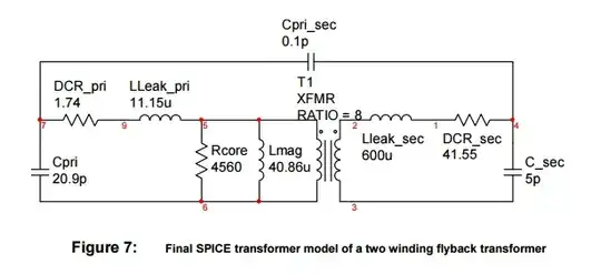

I'm planning to use it for parts in a home made power supply project. There is an unidentified transformer (marked VRL35W015 on its top, SBI 4.2 E150436 C on its side) which I'd like to know how I can check its features, e.g. frequency range, max current, voltage and whatnot. The SBI 4.2 marker lead me to a Taiwanese company that does unfortunately not publish the specification for that transformer type.
Apparently the transformer has two primary and two secondary windings. How can I check the characteristics of this transformer? Is there a typical circuitry I can build to check it out?

This transformer also has 6 pins on the secondary, wired together in adjacent pairs on the PCB, the primary four pins, independently connected. The document pointed to by Andy Aka seems to confirm, like the hinted thread, the fact that this transformer has been specifically designed for this Antec Neo HE. Not any reason to ditch this transformer, to me of course.
I will observe (frequency, voltages and apparent ratios) with my oscilloscope how the transformer behaves. This will hopefully give me basic information, which I'll further use in my "quest". Lot of fun ahead.
