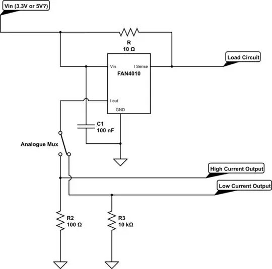

I'm going to design with the FAN4010 datasheet, because I think it looks slightly better at this time:
You want the voltage across the sense pins to be maximised as much as possible, because that makes it much more noise immune. As you can see I used 10 Ohm, which means 0.3V drop at 30mA already, which may be too much for you, but 10Ohm is still relatively low, we'll look at a possible fix for that later.
With 10Ohm, the sense voltage will be 10uV for 1uA of drain, which means exactly 1uA of output current. Well, not exactly, because the amplifier has 5nA input current, which it adds to the Load current (but that's 0.5%) and an offset output current of 2uA. Funny thing is, that for small signals (<10uA) you can subtract a known offset current from the measurement and still get within a 5% accuracy. So you have the device measure the offset leakage through the high value resistor, with the load turned off (more on that later) and then subtract that voltage from every measurement across that larger resistor.
1uA through the 10kOhm resistor would become 10mV, again with such low currents you do need special attention to the design to keep out noise, but 10mV is easier to guide through amplification than 0.25mV already. And you could possibly use 50kOhm, or 100kOhm, depending on the ranges you want to measure and whether you also add a 1x/100x selectable gain amplifier later.
If you get 30mA into your load, you would get 0.3V of sense voltage, which is 3mA output current. That would cause a huge voltage across the 10kOhm, but the amplifier will just "clip" high, while the load still gets its 30mA with no problems: One risk fixed. Then you can switch to the 100Ohm resistor, which suddenly gets you back to 0.3V (or 10mV per mA), which is again easy enough to work with given a little attention.

  • first of all thank you for the long reply, I bet that took a lot of time. when I checked the FAN4010, its stated that the Vsense is supposed to be 10mV-200mV(page 7). when my current is 1 uA, and by using a 10 ohm resistor, my Vsense would be just 10 uV which is in turn not included in Vsense range. and my Iout would not be 1uA, it would be 0.1 uA not 1, I bet you just had no time and you miscalculated things. my second q is, in short, is adding the Lm317 to regulate the current and to get rid of the noise ? or what is exactly the its function? I spent smtime trying to figure @Asmyldof – Sabir Moglad Nov 15 '15 at 16:58
  • @SabirMoglad Those are exactly the details I didn't really have time to work out, just quickly looked at the transfer ratios and Vin limits and worked from memory. There are chips like this one (may be a bit more pricey) that can do it, or else you may have to build its insides yourself with a very good op-amp. The LM317 (will have to replace with a better choice, probably) is made to regulate the load voltage, by adjusting the Vin as the load current changes. It creates a constant output voltage just before the switch, where its feedback is connected. – Asmyldof Nov 15 '15 at 19:30
