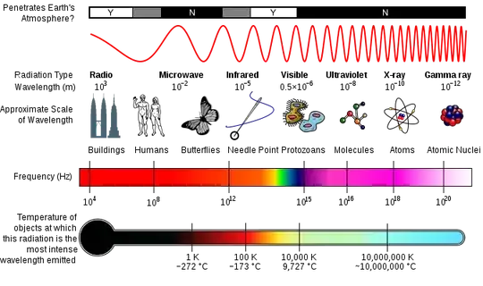

Electromagnetic radiation can be nasty at some energies, but the EM radiation from your cell phone isn't dangerous. Radiation is dangerous as such when it is ionizing radiation - capable of removing electrons from an atom, creating an ion. Ions are chemically reactive, and it's the reaction that causes harm.
Take a look at this image of the electromagnetic spectrum from Wikipedia:
http://en.wikipedia.org/wiki/File:EM_Spectrum_Properties_edit.svg
Your cell phone operates between the radio and microwave frequencies. Ultraviolet light (such as that created by the sun) is the lowest-frequency ionizing radiation.
My initial reaction is that this is total quackery, but let me ask those more knowledgeable in the field: is there any substance to these things?
If you're not convinced by or don't understand the ionizing vs. non-ionizing radiation argument, note that visible light is closer to being a "nasty" ionizing form of radiation than radio waves. Don't worry about it.
leftaroundabout points out that radiation can also be dangerous at high frequencies due to thermal effects. However,
  • Low power levels,
  • Large thermal mass in your head, and
  • High conductivity of any thermal effects by your blood
combine to make this a non-issue.

    Ionizing is certainly the most immediate kind of harm that radiation can commit, but you can't _conclude_ from this that non-ionizing kinds of radiation are per se harmless. If you stick your head in a microwave oven, no molecule is directly ionized by the microwaves, and it's still deadly since your brain doesn't like to be boiled. – leftaroundabout Sep 27 '11 at 11:12
    @leftaroundabout - Brain boiling power requires a lot more transmitted power than your phone antenna could ever approach. Your microwave outputs somewhere around 1000W, but your cell phone outputs less than 1W, which is not enough to cause a significant rise in temperature. Holding your hand to your ear will cause more heating than your phone would. – Kevin Vermeer Sep 27 '11 at 11:23
    Yeah, I didn't say phones boil your brain. I just said it's a wrong conclusion to say \$x\in A\$ are dangerous, \$B\not\subset A\$, therefore any \$y\in B\$ are harmless. – leftaroundabout Sep 27 '11 at 11:35
    @leftaroundabout - OK, I'll bite. Added to answer, should be comprehensive now. (Unless you want to consider the effects of a phone accelerated to a high velocity, or ingested...) – Kevin Vermeer Sep 27 '11 at 11:59
    My $0.02 - conflicting studies are absence of proof. In general, absence of proof is not proof of absence. Adding some common sense (non-ionizing radiation, lower power levels on newer phones) makes me judge there to be no risk - [Wikipedia article](http://en.wikipedia.org/wiki/Mobile_phone_radiation_and_health) – Adam Lawrence Sep 27 '11 at 12:57
  • Just to add a little bit to what @leftaroundabout said: EM radiation from cell phones can and probably does warm the body, but since a cell phone transmits at much less than 1 watt, the effects are tiny. By comparison, the light from the sun strikes the earth with approx. 1,000 Watts/meter2. So the sun has much more warming ability than a cell phone could possible have-- and the sun outputs UV light, which _IS_ ionizing radiation. From that we can conclude that the non-ionizing radiation from a cell phone is less harmful than the sun. –  Sep 27 '11 at 13:01
