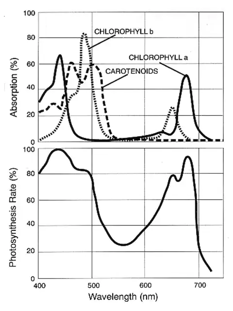

When I have a look at the PAR it looks completely different, in fact almost reversed:
PAR
(Copyright: John Whitmarsh and Govindjee)
On the other hand we also have this weighting:
Weighting for photosythesis
(Copyright: Hankwang)
I'm not an expert on this topic, so I can't tell which of the both curves is more relevant, and why they look so different, but both of them deviate strongly from the luminosity function.

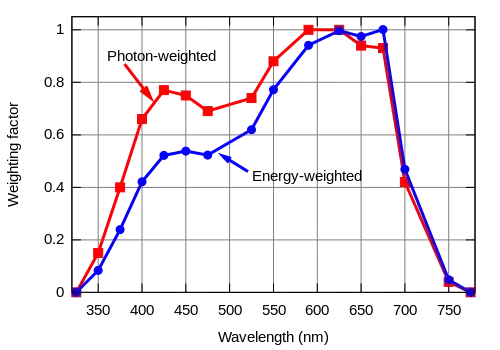

Weighting the spectra with the standard luminosity function:
lumens weighted spectra
Integrating over them and dividing with the integral of the relative power spectra results in:
  • cold LED: 0.46712
  • warm LED: 0.47969
  • plasma: 0.39181
So if that would be correct the plasma has a lower lumens output than both of the LEDs, but the warm LED should have less than the cold LED, so I am missing something here.
