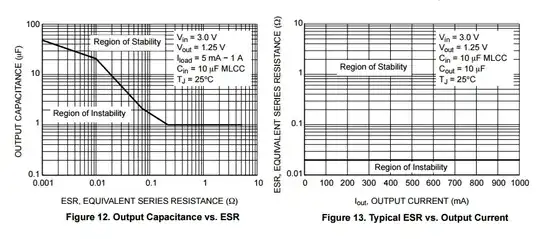

Frequency compensation for the regulator is provided by capacitor Cout and its use is mandatory to ensure output stability. A minimum capacitance value of 4.7µF with an equivalent series resistance (ESR) that is within the limits of 33 mΩ (typ) to 2.2Ω is required. See Figures 12 and 13. The capacitor type can be ceramic, tantalum, or aluminum electrolytic as long as it meets the minimum capacitance value and ESR limits over the circuit’s entire operating temperature range. Higher values of output capacitance can be used to enhance loop stability and transient response with the additional benefit of reducing output noise.
[emphasis mine]. That datasheet has nice graphs that show the interdependence of these two output cap parameters (ESR and capacitance):

Note that this EM simulation is only about the effect of the board, it does not include things like stability of voltage regs. And if you put the two chips and their caps really close to each other, the lack of trace inductance/resistance between them may actually be a problem for the stability of the LDO: the capacitance it sees grows (sees caps in parallel), but the ESR goes down (resistors in parallel). That moves you to the left in graph in Fig 12 above. That's why nothing is ultimately the substitute for actual prototyping.
