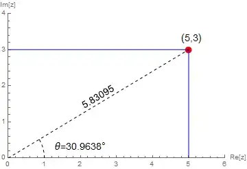

Think of the real and imaginary components shown graphically on the complex plane. X is the real axis and Y the imaginary one. Now plot the vector from the origin to (5, 3). This vector nicely shows the complex impedance. Its magnitude is the impedance magnitude, and its angle from 0 is the impedance phase angle.
Now you should be able to see how the answer above was arrived at. Draw it on a piece of paper if that helps. Then please come back and show us how the answer was derived. By the way, I just did the calculations and agree that the answer you give is correct other than being expressed with excessive precision.

Let me add a picture for the benefit of future visitors to this page.
