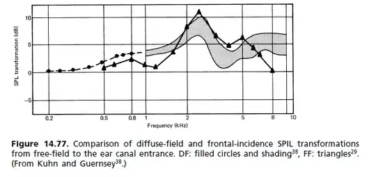

(a) Free-field response: For want of any better reference, the various international and other standards have set up the following requirement for high-fidelity headphones: the frequency response and perceived loudness for a constant voltage mono signal input is to approximate that of a flat response loudspeaker in front of the listener under anechoic conditions. The free-field (FF) transfer function of a headphone at a given frequency (1000 Hz chosen as 0 dB reference) is equal to the amount in dB by which the headphone signal is to be amplified to give equal loudness. Averaging over a minimum number of subjects (typically eight) is required. [...] Figure 14.76 shows a typical tolerance field.
(b) Diffuse-field response: During the 1980s there began a movement to replace the free-field standard requirements with another, where the diffuse field (DF) is the reference. As it turned out, it has made its way into the standards, but without replacing the old one. The two now stand side by side. The dissatisfaction with the FF reference arose principally from the magnitude of the 2 kHz peak. It was held responsible for coloration of the image, since frontal localization is not achieved even for a mono signal. The way in which the hearing mechanism perceives coloration is described by the association model of Theile (Fig. 14.62). A comparison of the ear responses for diffuse field and free field is shown in Fig. 14.77. [...] Since the subjective listening test is the one that counts, FF headphones have so far been more the exception than the rule. A palate of different frequency responses is available to cater for individual preferences, and each manufacturer has its own headphone philosophy with frequency responses ranging from flat to free field and beyond.

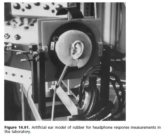

At factory or in a lab an artificial ear is used when measuring the frequency response. The one below is a lab-level one; the factory-level ones are a bit more simple.

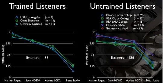

Here are a couple of interesting slides from one of their earlier presentations. First, the full frequency response (not truncated to 12KHz) of HD800 and on more clearly disclosed equipment:
And perhaps of most interest to the OP, the bassy sound of the Beats isn't all that appealing, granted in comparison with headphones that cost four to six times as much.
