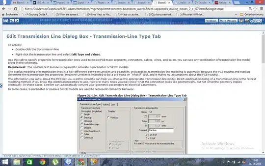

Also i'm not able to add SLM (single line model) for the connector in BoardSim but the net can be exported to LineSim where transmission lines can be added to trace and described as a connector where SLM models can be added like this: enter image description here
But even after doing this I dont get simulations on the oscilloscope. I get the same error there too. What am I doing wrong?

  • Thank you for your answer but can you direct me on how to add SLM models and MLM models to a connector in BoardSim. Hyperlynx allows to add SLM in LineSim but there is no help about MLM (multi-line model) in it. How do I add MLM model to a connector? Also can we add SLM to a connector in BoardSim. – Xavier Gonsalves Nov 10 '15 at 07:34
  • I will be in Hyperlynx later this morning, and I need to add models to a connector as it happens, so I will record it when I am doing it then. – Peter Smith Nov 10 '15 at 07:50
