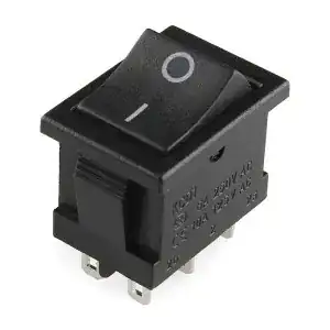

DPDT switches, i.e, toggle switches. The rocker type make clicker noises and look nice if that's what's you're going for. They stay on the setting you just put it on unlike momentary(pushbuttons) switches.

  • Then you're going to want to go with a rocker switch. They produce a fairly audible sound that resembles that of a push button momentary switch. – Enthurzan Nov 09 '15 at 00:11
