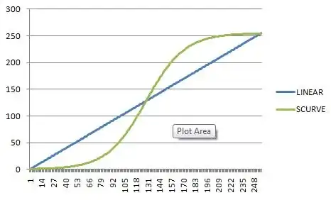

After a bit of playing around with LOG and SIN functions, the average of the two, and a few other things, I couldn't really get the right curve. What is happening is that the middle part of the fade was happening slower than the lower and higher levels. Also, if a fade-up is immediately followed by a fade-down there was a sharp noticeable spike in the intensity. What is needed (in my opinion) is an S curve.
A quick search on Wikipedia came up with the formula needed for an S curve. I plugged this into my spreadsheet, and made a few adjustments to make it multiply across my range of values, and came up with this:
S curve
I tested it on my rig, and it worked beautifully.
The Excel formula I used was this:
=1/(1+EXP(((A2/21)-6)*-1))*255
where A2 is the first value in column A, which increases A3, A4, ..., A256 for each value.
I have no idea if this is mathematically correct or not, but it produces the desired results.
Here are the full set of 256 levels that I used:
