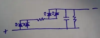

My son's fish-lava light LEDs burned out. Here is the simplified version of the circuit (some components removed for clarity):
I've spent the last few days researching LED circuits. I realize that the circuit is not an ideal configuration and I see the reason it burned out. Since I'm working with a fixed board, I was looking for a formula to calculate the resistance for the resistor on the left (between the sets of LEDs).
I found a similar question was asked a few months ago but the answer there is "don't do that". Unfortunately, that's what I'd like to do only because it seems easier to replace a few 30c LEDs and resistors each time it burns out than to create a new board. In addition, I'd really like to understand the theory even though the practical application isn't desirable.
How does one go about calculating the resistance for a single resistor protecting LEDs in a mixed series/parallel configuration?

  • "components removed for clarity" is usually a big mistake. Where does it end - a blank sheet of paper. Answer not provided to keep this question page as clean and clear as possible. – Andy aka Oct 30 '15 at 17:54
  • The + and - connect through a bridge rectifier to a 12v power source. That's the entire circuit. – NRF Oct 30 '15 at 18:06
  • The single resistor argument is compelling! Bloody cheapskate designers! – Andy aka Oct 30 '15 at 18:08
  • Indeed! I'm considering cutting down a perfboard into a circle and doing it the "right way" but the theory has me hooked. – NRF Oct 30 '15 at 18:11
  • Two series LEDs can share the same resistor so you need one extra resistor but both new resistors have to be double the value of the original resistor. – Andy aka Oct 30 '15 at 18:15
  • That's what I'd do if I was designing the circuit- what you're pointing out is the "right way". However, since I'm working with a manufactured board there isn't a configuration where I can put another resistor (or, at least, I haven't found one yet). – NRF Oct 30 '15 at 19:34

Since you already read the posts you mentioned, you already know that you can't calculate the resistor because you don't know how the current is divided between parallel diodes/LEDs.
You didn't give details about the board. Would it be possible to enlarge one of the LED terminal holes (if it is a PTH LED) and solder a small resistor in series with each LED?
Pedro
  • Can't calculate the resistance? Could we calculate it given ideal LEDs and worst case LEDs, then guesstimate what resistor to use? Apart from that, that's a good idea to try and put a resistor per LED. Space is a bit tight, but that may be doable. I'll play around with the components... – NRF Oct 31 '15 at 01:49
