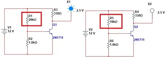

In the circuit above , I am not really sure how it work? when R5 is 10k ohm , BJT is in the on state and when R1 is increased to 20k ohm , BJT is in the off state
To fully turn on the BJT , Vbe must be greater than 0.7 but when I apply voltage divider rule , isn't R6/(R6+R5) * 12 v = 1.091V. Isn't this amount more than 0.7V which should turn on the BJT but it doesn't as shown in the multisim simulation.
I am still learning how BJT work so I simulate this in Multisim.

  • That doesn't look like an LED in series, it looks like .. some sort of measuring thing? What are X1 and X2 with the "2.5V" marker next to them? – pjc50 Oct 29 '15 at 14:08
  • My bad . it is not really an LED. I use the probe as an indicator to see whether the BJT is turn on or off – BlueEye Oct 29 '15 at 14:15
    When transistor is ON, the lamp should be OFF, and vice versa. Which seems to be what you are getting. – Chu Oct 29 '15 at 14:19
  • Can I have more explanation on how it work? Why does the increase in resistor will lead to the BJT being turned off? – BlueEye Oct 29 '15 at 14:21
  • When a BJT is 'on' we mean that current is flowing through the collector. At this point you will get a voltage drop across your collector load resistor R4, and the voltage at the collector will drop to close to 0V. – Icy Oct 29 '15 at 14:36
  • Ya I understand that part when BJT is 'on'(VCE = 0). But how to actually turn it 'on'? why when R5= 10k ohm and R6= 1k ohm , it is 'on'? How do I calculate the value of R5 and R6 such that it will turn 'on'? since Vbe requires 0.7V to turn on fully – BlueEye Oct 29 '15 at 14:49
The voltage divider rule between your two resistors does not work like you think because the base emitter junction of the BJT tends to go up to about 0.7V and then not go much higher whilst the current into the base can increase more and more. In other words the BE junction clamps the voltage level between the two resistors to about 0.7V.
When the R1 value is increased to a certain level the voltage at the BJT base lowers down below the 0.6 to 0.7V level and the transistor starts to shut off. At some point the voltage divider will begin to act like normal as the current into the base approaches zero.

Since the OP is not yet quite getting it let me be specific with the examples that were posted. It is correct that at a voltage in range of 0.6 to 0.7V the transistor will begin to turn on.
Let's look at the 20K//1K case in the left picture. Assume for a moment that the transistor base is not connected to the two resistors. By the voltage divider equations the divider voltage is:
Vb = (Vsupply * R6)/(R5 + R6) = (12V * 1K)/(20K + 1K) = 0.571V
This voltage is less than the voltage needed to turn on a transistor so if you would reconnect the transistor base to the divider there will be virtually no current flowing into the base of the transistor and the voltage divider will remain near this 0.571V value.
Next step is to visualize what happens in the above equation when the R5 value is decreased. The divider voltage will increase slowly as the R5 value is decreased.
As R5 decreases more and more the Vb divider voltage will rise up to to the point where the transistor wants to begin turning on. That will be in the 0.6 to 0.7 voltage range. At this point the transistor base begins allowing some of the current from R5 to flow into the base of the transistor.
Be aware that transistors are current mode devices and are actually turned on when the current into the base starts to flow. Below the Vbe threshold the current is nearly zero. As the divider gets past the Vbe threshold the current into the base increases and the transistor starts to turn on.
Ok lets go back and decrease the value of R5 a little more. The lower resistance of R5 allows more current from the 12V supply to flow to R6 and the base of the transistor. The voltage across R5//R6 divider will no longer follow the above equation because the base of the transistor is placing a load on R5 and stealing current so that R6 does not get as much. The nature of the transistor base-emitter junction is that the current into the base can increase more and more whilst the voltage of the base will change only a little.
As I said before the base of the transistor begins to act like a clamp on the voltage divider not allowing the Vb to increase much above the 0.7V level as R5 is made increasingly smaller and smaller. Instead the base current increases to the point that the collector current starts to flow and the transistor eventually turns full on.
The amount of base current needed to turn the transistor full ON will depend on how much collector current is allowed to flow which is limited by components in the collector circuit. The relationship between the base current and the collector current is called the transistor gain or Beta. If the collector current is limited then the transistor will saturate to a Vce of near zero volts when the base current has reached a sufficient level.
It is possible to keep lowering the value of R5 more and more causing the base current to increase more. But beyond the level that caused saturation (Vce near zero) the Vb will only increase slightly and no additional collector current will flow because it has reached the level limited by the components in the collector circuit.

  • To turn on BJT fully , it requires about 0.7V so to turn on the voltage across R6 must be greater than 0.7V? am I correct? I think I am a bit lost. – BlueEye Oct 29 '15 at 14:37
    @BlueEye - I tried to explain it in my answer but clearly I did not do it in a way that you got it. Do you understand the voltage divider equations? I'll add some more to my answer. – Michael Karas Oct 30 '15 at 12:09
