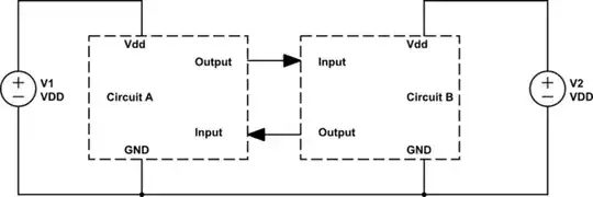

Assume the following, generic, configuration in which two digital circuits are interconnected but have independent power supplies (e.g. two redundant microcontrollers).
Now, what happens if V1 is ON but V2 is OFF (or vice versa)? I generally protect against this scenario by inserting resistors on the lines such that the short circuit current is below the max sink current of the pins.
  1. Is that necessary (perhaps something to look for in the datasheets?)? What would happen to the transistor level if no protection was included? Generally, enhancement mode MOSFETs are used, which means all switches are OFF (open) when no voltage is present, therefore I do not understand why there could be an issue.
  2. Are there other means of protection? Those resistors prevent me from running communication lines at high frequency because of the time constant with the input capacitance.

What you are looking for in the datasheet is the pin structure schematic (or diagramm).
It may look something like this: STM32F401 pin strcuture
What you see here in particular are the protection diodes which clamp input voltages to the allowed region. Often it is given as Vdd+0.3 V and Vss-0.3 V or something like that.
The 0.3 V is the voltage drop of the protection diodes. If you have a voltage higher than Vdd+0.3 V the protection diode will start to conduct and supply current to the rest of the circuit.
Your circuit and the controller is of course not supposed to work in that way. For example you could be reverse biasing your voltage regulator on the other side, if the power failure is caused by the input of the voltage regulator breaking down (details depend on the way your power circuit is designed). This can damage your voltage regulator.
Depending on the current draw of the other circuit the actual voltage might be quite a bit lower so the components won't work as expected. For example when driving 20 mA the voltage of the output is reduced by 1.3 V:
Pin voltage levels depending on current
So running from 3.3 V you'd get 2.0 V at the output and only 1.7 V as the new VDD on the other side. Which might cause all sort of troubles (some chips work already, others don't).
I'm not sure on the protection side of things, but maybe a power supervisor which holds the MCU in reset until both voltages are OK might work, as you then can be sure that both are powered correctly.
If you need to have one running all the time you might use a supervisor on each side for the other side and turn off all lines between them if the state is not okay, but as the reaction won't be instantaneous (software involved) it might be too slow.

Use a series diode from each power supply to each Vdd, and increase the supply voltage to compensate. This will allow the input protection diodes to power the circuit, without being loaded by the 'off' power supply.
This won't necessarily allow the input-powered circuit to work properly. It's supply voltage will be lower, due to the drop of the protection diode and any output drop on the data line. If all the lines from the powered circuit are low, then there will be no power at all. However, the current delivered by the data line will be limited to that required to run the unpowered logic, rather than everything else connected to the power supply as well.

A lot of bad things can happen with the situation you show, many of which have been suggested by others above, but the damage ultimately depends on what kind of circuit you have for CircuitB.
The biggest thing to avoid are:
  • Having the CircuitB draw to much current from the pins of CircuitA, as you pointed out.
  • Accidentally powering CircuitB through the outputs of CircuitA.
There are a couple of solutions to address these issues, and they entirely depend on a series of engineering trade-offs, like all things engineering related.
  • Isolation: Using isolation to separate both circuits will give you best results, but tends to be costly. Isolating GNDs will give you by far the best results, but isn't necessary.
  • Special IC: Use ICs specifically designed for this. For instance, the TXB0108 or the SN74AVC4T245 feature the Ioff functionality mentioned by Peter Smith.
  • Buffer Hack: Place a buffer (74HC244, or something similar) from CircuitA to CircuitB, and have the Output Enable (OE) pin driven from CircuitB. If OE is active low (as most buffers are), you might need to have the pin pulled-up with CircuitA's supply and have CircuitB pull it down to GND. You could also add weak pull-downs on the output of the buffer to prevent your data lines from floating. You'd have to duplicate this circuit in the reverse direction s.t. you can go from CircuitB->CircuitA.
If CircuitA can control CircuitB's powered state, you can cheat and use a load switch to, in effect, tie VDD2 (from CircuitB) to GND, and then make sure your output pins from CircuitA be driven to GND or tri-stated with pull-downs on the pins prior to powering off CircuitB. But I don't think this is your situation.
