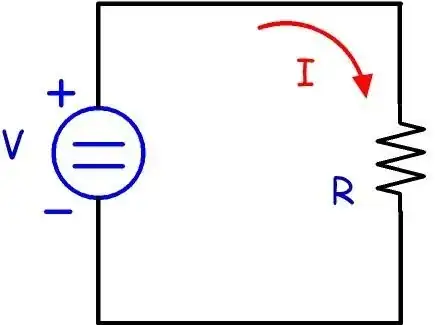

With the following circuits as examples :
http://knol.google.com/k/-/-/1f4zs8p9zgq0e/lxzei8/ohm-1.jpg
and
http://hades.mech.northwestern.edu/images/4/45/Parallel_resistors.gif
How will the current I know how much to flow? Would any other wave travel first in the circuit and then come back and say so much current should flow?

Not sure if this is what you're asking, but yes, when the battery is connected, an electric field wave travels from the battery down the wires to the load. Part of the electrical energy is absorbed by the load (depending on Ohm's law), and the rest is reflected off the load and travels back to the battery, some is absorbed by the battery (Ohm's law again) and some reflects off the battery, etc. Eventually the combination of all the bounces reaches the stable steady-state value that you would expect.
We usually don't think of it this way, because in most circuits it happens too quickly to measure. For long transmission lines it is measurable and important, however. No, the current does not "know" what the load is until the wave reaches it. Until that time, it only knows the characteristic impedance or "surge impedance" of the wires themselves. It doesn't yet know if the other end is a short circuit or an open circuit or some impedance in between. Only when the reflected wave returns can it "know" what's at the other end.
See Circuit Reflection Example and Transmission line effects in high-speed logic systems for examples of lattice diagrams and a graph of how the voltage changes in steps over time. See Termination of a Transmission Line for an animated simulation of different terminations that you can modify, and this for a light switch example.
And in case you don't understand it, in your first circuit, the current is equal at every point in the circuit. A circuit is like a loop of pipework, all filled with water. If you cause the water to flow with a pump at one point, the water at every other point in the loop has to flow at the same rate.
The electric field waves I'm talking about are analogous to pressure/sound waves traveling through the water in the pipe. When you move water at one point in the pipe, the water on the other end of the pipes doesn't change instantly; the disturbance has to propagate through the water at the speed of sound until it reaches the other end.

Since the theory has been covered, I'll go with a rough analogy (Hopefully I'm understanding what you are asking properly, it's not so clear)
Anyway, if you imagine a pump (the battery), some pipes filled with water (the wires), and a section where the pipe narrows (the resistor)
The water is always there, but when you start the pump it creates pressure (voltage) and makes the water flow around the circuit (current). The narrowing of the pipe (resistor) restricts the flow (current) to a certain amount and causes pressure drop across it (voltage across resistor, in this case equal to the battery)
With the second circuit (two resistors in parallel) it is reasonably clear that the same amount of current that flows into the top junction must flow out from the bottom junction (see Kirchoff) If the resistors are the same, then they will share the current equally. this can be though of as one large pipe (wire) splitting into two narrower pipes (resistors) and then fusing back into one large pipe again. If they are unequal, then one will take more flow (current) than the other but the total out will always add up to the total in.
You could ask the same question with the water analogy - how does the water "know" how much to flow? Because it's limited by the pipes width and the pumps pressure.

At first, the current doesn't really know. Assuming a big cartoony switch in the line, when open, it represents a huge impedance. (Capacitive) charge builds up on either side of it; specifically, electrons crowd the negative terminal and the positive terminal lacks the same number of electrons from normal (image charge). Current flow is negligible (fA*), so there is no potential drop across the resistor. Electrons have no net movement or flow because the electrostatic repulsion with their neighbors, including the big bunch at the switch, is equal to the force from the external electric field bias.
When the switch is first closed, the extra electrons near the switch zip to the other contact, filling in the image charge. Now that there isn't a big bunch of bully electrons refusing to move and pushing back, the rest go ballistic (hah! not actually, though) and start to zip through the circuit.
Those in and near the resistor meet ... resistance (c'mon; I had to). There aren't nearly as many free electrons or sites, so, not unlike the very large impedance presented earlier by the switch, charge builds up on either end as the impatient buggers jostle for a spot in line. It continues to build up until equilibrium is reached: the electrostatic field from the bunch of electrons waiting to get through the resistor is equal to the external electric field bias.
At this point the current knows how much to flow, and won't change ['til you realize that you put in a 1.3-ohm resistor instead of the 1.3-kohm, and it fries and open circuits again].

"Knowing" how much to flow implies knowledge, which implies intelligence.
Current is not intelligent, and doesn't flow per se. Current is pulled, or "drawn" by the load - in this case the resistors.
The amount of current the load draws is determined by Ohms Law:
\$I=\dfrac{V}{R}\$

Nobody mentioned the fact that all schematics adopt the so-called lumped element model.
In a schematic a wire is not a wire in the common sense, it is a simplifying relationship between nodes. If you wanted to describe step by step what happens to the current (or what it "senses") along a wire, you would have to draw an infinite series of passive elements.
Actually, the current doesn't know how much to flow at t=0.
Every resistor have some capacitance, since they consist of the conducting sides separated with an insulator (even though not perfect). Because of this capacitance, at t=0, current rushes as much as the power supply can supply. Then it slows down after a while to its normal value. Every practical resistor can be modeled as a resistor and a capacitor in parallel. So, your first circuit is actually a parallel R-C circuit.
Also, don't forget that E field (electric field) creates B field (magnetic field), and vice versa. When you apply a voltage across the resistor, what you do is you create an electric field inside the resistor. Which causes a change in the state of the electric field (you rise electric field from zero to a non-zero value). The change in the electric field creates magnetic field and it finally creates a flow of current.
Please refer to Maxwell's Equations for more information.

Actually, waves have a lot to do with it, until a steady state is achieved. Initially, even the most simple circuit made of a battery, a switch, a wire, and a resistor, is a transmission line, surrounded with electromagnetic waves, and requires a transient analysis to understand. This transient analysis will answer the initial question in this blog, if I understand the question... Even the battery is complex, and initially, until steady state is achieved, requires an analysis that is governed by maxwells eqn's, and more. In years past, DC101 was initially taught using the analogy of water in pipes, etc. Analogies were drawn for inductance and capacitance too. It is a great way to help someone understand DC, if you have five minutes to teach it to them, and ohms law is as far as you will take your student.

Your question is a bit garbled and I don't see how waves have anything to do with this. However, the basic Ohm's law is easy to explain in your example. Both resistors have voltage \$V_S\$ across them. That means the current through them will be \$\frac{V_S}{R}\$. Specifically
\$I_1 = \dfrac{V_S}{R_1}\$
\$I_2 = \dfrac{V_S}{R_2}\$
\$I_S\$ is merely the sum of the two currents through the resistors:
\$I_S = I_1 + I_2\$
You can get \$I_S\$ another way, by considering the equivalent resistance of \$R_1\$ and \$R_2\$ in parallel.
In general: \$R_1 || R_2 || ... R_n = \dfrac{1}{(\dfrac{1}{R_1} + \dfrac{1}{R_2} + ... \dfrac{1}{R_n})}\$
\$R_1 || R_2 = \dfrac{1}{\dfrac{1}{R_1} + \dfrac{1}{R_2}} = \dfrac{R_1 \times R_2}{R_1 + R_2}\$
Using Ohm's law again, it is straight forward to compute Is:
\$I_S = \dfrac{V_S}{R_1 || R_2} = V_S \times \dfrac{R_1 + R_2}{R_1 \times R_2}\$
Note that this is the same answer as above where we computed the current through each resistor and added them to get \$I_S\$:
\$I_S = I_1 + I_2\$
\$I_S = \dfrac{V_S}{R_1} + \dfrac{V_S}{R_2} = V_S \times \dfrac{1}{R_1} + \dfrac{1}{R_2} = V_S \times \dfrac{R_1 + R_2}{R_1 \times R_2} = V_S \times (R_1 || R_2)\$
