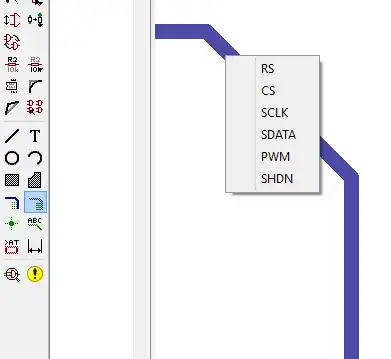

Once the bus is named you can then use the Net tool (the one next to the Bus tool) to start drawing a net from the bus. With the Net tool, if you click on the bus you will see something like below. If you have any [x..x] entries as mentioned above, you will see them all grouped into a sub-menu.
net menu
You can then click on any menu item to start drawing a wire in that net. Basically this is equivalent to first using the wire tool and then the name tool. You can use the wire tool to extend nets that you started drawing with the net tool.
