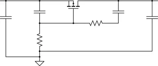

An established method is to use a form of soft-start
http://www.ti.com/lit/an/slva156/slva156.pdf
There is equally monolithic chips that provide the same functionality.
http://www.onsemi.com/pub_link/Collateral/NCP330-D.PDF

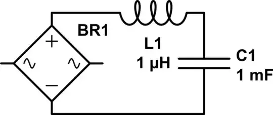

A quite simple solution (I'm surprised it's not mentioned already) is to add a small coil after the rectifier:
A coil doesn't add much active resistance and doesn't practically affect the efficiency under "steady state" operation. The current spike is suppressed by the inductance which limits the current rising slope by $$L=\frac{dI}{dt}$$
