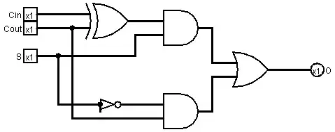

I am suppose to design a carry look ahead adder with ...
Input flag bits
  • E (Enable)
  • S (Subtraction)
Output
  • The usual sum & carry out
  • O (Overflow)
  • N (Negative)
  • Z (Zero)
But the question is vague ... It says if
  • E = 0, S = 1, do subtraction
  • E = 0, S = 0, do addition
  • then if E = 1? What do I do? What do usual circuits do? I suppose if 0 is enable, 1 is disable, then I put all outputs 0?
  • For overflow bit, I suppose the below, where \$C_{in}, C_{out}\$ are carry in/out of MSB/Sign Bit and \$S\$ is subtract bit. The 1st half checks if Cin is different from Cout (of MSB), when doing subtraction. And the 2nd half checks if theres a carry out when doing addition. Is my implementation correct?
  • For negative bit I also check if doing subtraction using \$S \cdot MSB\$?

Ask your professor if the question is vague. But your assumption that E=1 means disable is probably correct.
