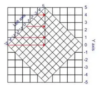

    This is actually not possible as a continuous mapping, unless you force a stop or discontinuity between the spin in place mode and one of the forward or backward turning ones, ban spin-in-place, or turn "the wrong way" in reverse. In research of full sized earth moving machinery manuals, the only tracked one I found with a single joystick was stated as unable to spin in place with the tracks. – Chris Stratton Sep 21 '16 at 05:06
Here's a solution that doesn't require complicated if/else chains, doesn't reduce the power when moving full forward or rotating in place, and allows for smooth curves and transitions from moving to spinning.
The idea is simple. Assume the (x,y) joystick values are cartesian coordinates on a square plane. Now imagine a smaller square plane rotated 45º inside it.
example plane
The joystick coordinates give you a point in the larger square, and the same point superimposed in the smaller square gives you the motor values. You just need to convert coordinates from one square to the other, limiting the new (x,y) values to the sides of the smaller square.
There are many ways to do the conversion. My favorite method is:
  1. Convert the initial (x,y) coordinates to polar coordinates.
  2. Rotate them by 45 degrees.
  3. Convert the polar coordinates back to cartesian.
  4. Rescale the new coordinates to -1.0/+1.0.
  5. Clamp the new values to -1.0/+1.0.
This assumes the initial (x,y) coordinates are in the -1.0/+1.0 range. The side of the inner square will always be equal to l * sqrt(2)/2, so step 4 is just about multiplying the values by sqrt(2).
Here's an example Python implementation.
