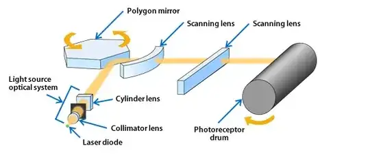

I opened up a broken laser printer yesterday to find one of the important sections (this is an example photo from Google Images), trying to learn from the design of the laser+polygon mirror motor within:
I was able to find the pinout of the driver chip, and successfully got the motor running at a very high RPM, as well as the laser to reflect off the rotating mirror, forming a simple linear pattern on the end surface.
Now, here is the part that's mysterious to me:
  • The mirror is just a standard BLDC (not a stepper nor an encoder-based servo).
  • The hexagon of mirrors is rotating at unknown/inexact speed.
  • There is such a high speed of rotation and such a short mirror length (I measured each side of the hexagon's mirrors to be about 2 cm long).
So how do they control the laser to reflect at the exact rotation-timing/angle of each mirror so as to (hit the photoreceptor drum at highly accurate positions and) produce printing quality in the thousands of DPI, i.e. better than 0.03 mm resolution?
In other words, how is the timing of the on/off laser pulsing coordinated with respect to the mirror angle in the below picture?

    Interesting question. I am not an expert. I'd observe that for a BLDC, then the speed is known, even if it is slightly inexact. If there were any feedback from the motor, e.g. a reflection back to the laser, or some sensor on the motor itself, then the speed might be quite accurately known by the printers hardware and software. For example, one accurate position 'pulse' per mirror 'flat' might be fine if the speed of the mirror doesn't change much during its sweep. Only a WAG, though. – gbulmer Oct 18 '15 at 14:02
    I trust you're wearing eye protection (in these experiments)... The rest is a good question. – Fizz Oct 18 '15 at 14:04
    The rotation of the mirrors is *very* exact. It is a synchronous motor with small and constant load angle aflter all. – venny Oct 18 '15 at 14:11
  • There are patents in this area, e.g. https://patents.google.com/patent/US5754215A/en? but they're a bit obfuscated. Let me see if I can find something clear. – Fizz Oct 18 '15 at 14:13
  • Have you looked at your printer carefully? Is there any sensor that it uses to read the mirror position (like in the aforementioned patent)? Ignore the generic schematic images you find in google, those don't contain all the details. – Fizz Oct 18 '15 at 14:33
    @RespawnedFluff: Good idea on patent-reading suggestion. I now found [this relevant one](http://www.google.com/patents/US8289582). And regarding your sensor proposition, I'm sure there is -- I'm at work and will check when I go home. However, I did learn there is a "synchronization detector" for *post-reflection*, as described in [this document](https://books.google.com/books?id=8wPekoJyfEUC&pg=PA2426&lpg=PA2426&dq=polygon+mirror+synchronization+detector) briefly. – sasha Oct 18 '15 at 14:42
  • @venny: The rotation speed is in the thousands of RPM. Let's take best case of 1000 RPM = 16.67 RPS. So if the rotation speed is off by even 0.01%, then we can have an error of 0.00167-fraction of a rotation = 0.6 degrees deviation. I cannot see how that can afford 0.03 mm printing resolution, especially post-spreading out of the reflected beam. – sasha Oct 18 '15 at 14:48
  • If the rotation speed is off, then the whole page will be stretched, but individual scan lines remain aligned. It all boils down to crystal oscillator, its jitter and thermal drift (but not absolute accuracy). – venny Oct 18 '15 at 15:19
    If the rotation speed is off by a small margin, then the circuitry simply need to adapt. Adjusting the speed of a motor with a mirror is difficult. Compensating for it by adjusting the electronics controlling the laser is easier. All you need to do is detect the error in the rotation speed, not necessarily correct it. – Cort Ammon Oct 18 '15 at 17:40
  • @CortAmmon is spot on. It's generally easier to measure a motor's speed/position than to control it precisely. In fact the measurement is a subset of the control system, so you could regard it as simpler by definition. – Chris H Oct 19 '15 at 08:37
  • @gbulmer: I next wish to reproduce something similar to this with a BLDC motor, for my own design. Do you think there is anything particular to the type of motor, or the circuitry, that is used within such a module made for a laser printer? Or can I just attach a small flat mirror to an arbitrary BLDC's shaft and get an equally precise result (minus the polygonal scanning)? – sasha Oct 30 '15 at 01:11
  • "*Do you think there is anything particular to the type of motor, or the circuitry ...*"? I don't know. By coincidence, a friend and I were intending to do a laser tear-down, but we haven't got around to it. If your printer's parts have part numbers, you might get some more information from a web search. Based on Respawned Fluff's answer, I'd expect the motor drive chip and circuitry to embed the 'smarts', and the motor to be of adequate quality to do the job. – gbulmer Oct 30 '15 at 03:00
