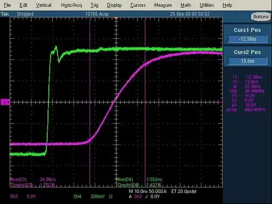

The right term for this "slow down" feature is slew rate. Adding a resistor reduces the slew rate by forming a low-pass RC filter with the input capacitance. You can see the effect of such resistors in the following oscillogram (green curve with higher slew rate produces much more noise):
The power consumption increase you mention is in fact not real. It takes the same amount of energy to charge a capacitor, regardless of how fast you are charging it. The introduction of the resistor only made this energy loss visible, whereas without the resistor the very same energy is dissipated by the CMOS output gates.

    Technically slew rate is not the correct term - you may have an amplifier or a driver or buffer with a slew rate limited output but adding a resistor to slow down a fast signal is simply that - it produces an exponential shape and the dV/dt isn't forced to some slew rate limit. – Andy aka Oct 16 '15 at 11:34
    Exponential shape does limit dV/dt by the initial slope of the exponent, V/(RC). But I do agree with the remark - slow slew rate pins are not made by adding resistors to fast slew rate gates internally. An ideal slow slew rate response is supposed to be linear, not exponential, and independent of the load capacitance. – Dmitry Grigoryev Oct 16 '15 at 11:43
    Rise time or edge rate, not slew rate – endolith Oct 17 '15 at 10:36
  • @endolith Care to explain the difference between edge rate and slew rate? Rise time is just voltage divided by slew rate, they really express the same thing in different units. – Dmitry Grigoryev Oct 17 '15 at 10:46
  • @DmitryGrigoryev Slewing distorts sine waves, RC filtering does not. Slew rate in op-amps is when the cap is charging from a current source and linearly approaches the final value and then stays there. "Rise time" applies to RC filters charged by a voltage source, producing an exponential decay that (theoretically) never reaches the final value, just asymptotically approaches it. http://www.radio-electronics.com/images/op-amp-slew-rate-01.gif http://www.radio-electronics.com/images/op-amp-slew-rate-02.gif http://www.ee.nmt.edu/~wedeward/EE212L/SP15/RCSquareWaveProbeFig2.gif – endolith Oct 19 '15 at 14:18
  • @endolith Rise time can be applied to slew rate just as well, I don't see why it should be the opposite of slew rate. Also, the difference between edge rate and slew rate is still unclear to me, I believe they are the same. – Dmitry Grigoryev Oct 19 '15 at 14:29
  • @DmitryGrigoryev Hmm. "Slewing" means rotating from one point to another. Wikipedia lists "rotating a telescope to observe a different region of the sky", "angular movement of a crane boom", etc. It starts moving, approaches the new position linearly, and then stops moving. "Slew rate" implies this kind of linear movement to me. Perhaps the terms can be used interchangeably, but this question is about RC filtering, and I haven't seen "slew rate" used for that before. – endolith Oct 19 '15 at 15:02
  • In my answer to Andy I already admitted that I have used the term "slew rate" a bit loosely. Resistors are put on digital lines to achieve that should ideally be achieved with the right slew rate on output pins. Of course, resistors can't really change slew rate, so they do the next best thing - they limit the initial slope by V/(RC). Later in the transition, the exponential character of the curve kicks in, but it hopefully happens after the digital input have already switched, so the whole system behaves **as if** you had pins with appropriate slew rate. – Dmitry Grigoryev Oct 19 '15 at 15:25
