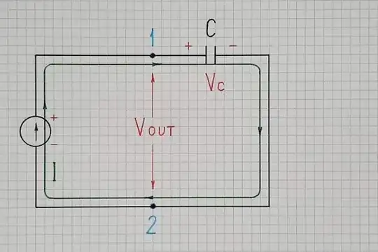

Building scenario
1. C current integrator. Due to its accumulating property, the humble capacitor can serve as a simple integrator with current input and voltage output - Fig. 1.
Fig. 1. A capacitor acting as a simple current-to-voltage integrator.
If driven by a constant current source, it would be perfect because the voltage drop across the capacitor will not affect the current (the current source is responsible for the constant current).
