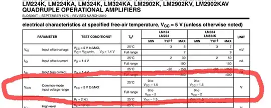

  • In normal operation, V+ and V- are the same. If they are different, the op-amp is being used as a comparator.
  • An important spec in choosing an op-amp is the "input common-mode voltage" range. The voltages at the inputs must be in this range for proper operation.
  • Some op-amps are "RRIO" or rail-to-rail input/output. As you might guess, this means the input common mode range goes from the Vee rail to the Vcc rail.
  • Some op-amps which include only the Vee rail in the common-mode range are referred to as "single-supply" op-amps.
Here is the spec in the LM324 datasheet: enter image description here

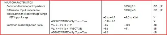

Generally there will be information about the common mode input range in the datasheets, here is an example of an opamp without a rail to rail input range (specs are for +/-5V):
Common mode range example
