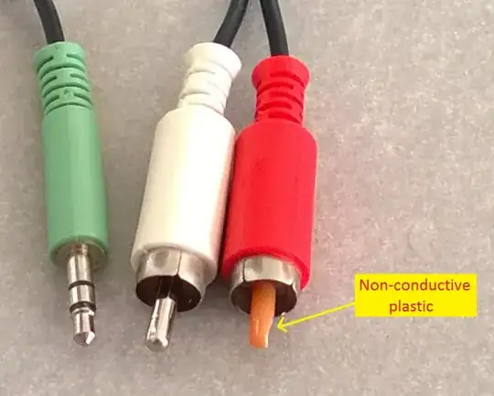

I noticed that my computer was playing sound out of only one speaker. The speakers are connected with a 3.5mm => 2*RCA cable, and when I inspected it, I found that the right RCA plug's inner pin was plastic (picture below). I replaced the cable with a regular cable, and now both speakers have sound.
The cable says Microlab on it, so it probably came with the speakers themselves (Microlab FC-330), though I'm not positive about that.
My question: What is the purpose of this kind of cable? Why would it be shipped with speakers?

    I'd guess the metal contact came off and the plastic is what is beneath it (much cheaper than a massive metal pin) and remained standing alone and without much use. – Arsenal Oct 09 '15 at 12:46
As @Arsenal correctly noted, it used to be a metal-coated plastic pin, and the metal broke off. I just discovered that after dissecting the cable with a knife. I also discovered that such knife can cut one's finger if one's not careful. band-aid thumb

  • Curiosity has hurt a lot of people, but the knowledge gained often comes with a feeling of accomplishment offsetting the pain you went through - well done! (hope your finger will get all right again). – Arsenal Oct 09 '15 at 13:22
    It might be worth checking that the lost bit of metal has not pushed all the way through the socket and is not now lying on your motherboard. – HandyHowie Oct 09 '15 at 13:27
  • Commiseration... – Fizz Oct 09 '15 at 13:29
  • @HandyHowie: No, I think it will be rattling around inside the speaker. – Dave Tweed Oct 09 '15 at 13:53
    @DaveTweed Of course. Looking forward to the next question - "Why is my speaker rattling?" – HandyHowie Oct 09 '15 at 13:59
