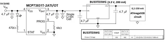

I have MCP73831T-2ATI/OT charge IC and BU33TD3WG 3.3 V 200 mA regulator available. Will this circuit work?
circuit1
There is 220 mV dropout voltage on the regulator so it won't work with VIN < 3.52 V?
I know there is a solution suing P-channel MOSFET to switch power sources, but I don't have any access to this type. I hope the circuit above should work.

    Are you expecting to keep the device plugged in normally, or only to recharge it? 0.5C should work just fine for "normal charging" the vast majority of polymer packs. If normally plugged in, charging current can be much lower, or even charge a supercap instead. Link to [MCP73831T](http://ww1.microchip.com/downloads/en/DeviceDoc/20001984g.pdf). – rdtsc Oct 06 '15 at 13:24
A typical LiPo battery can be charged with 1C however, will your USB supply this? If the device is only registered as a USB low power device, you should draw no more than 150mA from the USB or there is the danger that the port either shuts down or (best case) limits the current to 150mA.
Furthermore you are worried about that the battery is charged while your controller is running. If that's the reason for needing 1C charge current I would add some capacity to decouple the uC current draw.
It is correct that the linear voltage regulator will subtract the drop-out voltage from the input voltage. This voltage is depending from the current. You can find the applicable dropout voltage if you check the datasheet. Normally there is a graph showing dropout-voltage over current.

    If vin of the LDO is below the (regulated) output voltage it will still supply voltage but unregulated. And it will still deduct the dropout voltage depending on current draw. E.g. Vin = 2V; Vout =2V - v_drop – optronik Oct 06 '15 at 13:33
