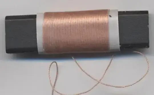

When it comes to receiving a radio wave you can still use any of the above but you can also use non-resonant antennas such as magnetic loops such as this: -
This is perfectly good for receiving long and medium wave transmissions - they convert the magnetic part of the incident EM wave to an electrical signal and just add a capacitor to tune and you have the front end of a regular AM receiver. But that mag loop cannot transmit hardly any distance at all even though it is resonated by a tuning capacitor.
Clearly, the small size compared with the wavelength of (say) 1MHz (about 300 metres) makes this the choice for simple AM receivers all the way up to several MHz.
The magnetic flux from the EM wave gets concentrated thru the ferrite and you have as many turns as possible (before self resonance becomes an issue) and you get a decent signal of maybe typically a few hundred micro volts. But because the flux gets concentrated in reception the same happens in transmission and, couple with the fact that it produces virtually no E-field to speak of makes it a really crappy transmit coil.

As already mentioned, a small AM receiver magnetic antenna tries to maximize the number of turns to convert the incident H field to as big a signal voltage as possible but the number of turns is limited by the inter-winding capacitance so to make it tunable there is a limit to the number of turns. Lower frequencies clearly can mean more turns.

  • This is excellent, but could you clarify a few things? I am not clear why a capacitor is used in the antenna circuit--I thought that's what the tuner circuit was for. Is there any benefit to having a larger closed loop antenna? I've seen one in my AM Radio and it's just a small iron core surrounded by wrappings, but I saw a commerical one that is about a foot in diameter. – Klik Oct 01 '15 at 00:30

  • @abc If you are winding multiple turn coils (like a ferrite rod antenna) then you want it to act like an inductor and, if the wavelength of interest is much longer than the coil size / wire length then it performs like an inductor but, you get little electric field because of the reason I gave - the wire length is much much smaller than the wavelength and cannot form a sizable E-field. – Andy aka Jun 16 '17 at 08:19
