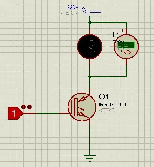

I've searched over the net on this issue but found no answers. In your own experience or thought, is it possible to use igbt as a switch?
If yes, please provide schematic as an example.

This is what I actually wanted:
I wanted to turn on the 220V bulb when the logic state is '1', and off when '0'. The problem is, I couldn't make it work.
Do you have a workaround for this?

  • What do you mean by "couldn't make it work" exactly? Did you try it for real, or simulate? Was it on all the time or off? What voltage was applied at the gate? – Oli Glaser Sep 09 '11 at 19:19
  • I couldn't make the bulb turned on. Yes, it's a simulation. I tried making it on and off alternately. The gate is 5 volts when '1' and 0 volts when '0'. – Neigyl Noval Sep 09 '11 at 19:23
  • Is that circular component connected across the bulb a voltage source? If so the IGBT will do nothing as it can't break the current loop through the bulb. The diagram is not very clear. – Oli Glaser Sep 09 '11 at 19:26
  • It's actually a voltmeter. I'm sorry, I failed to put labels. I actually used Proteus ISIS for that. – Neigyl Noval Sep 09 '11 at 19:31

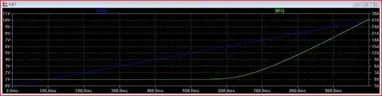

  • See updated answer regarding gate voltage. I used a spice model I found on the web for the part number shown in your diagram. – Oli Glaser Sep 09 '11 at 19:44

Edit - here is a Gate voltage (blue) vs Drain-Source current (green) for the IRG4BC10UD, notice at 5V it is still firmly off:

  • Thank you for the answer. I actually like to create a PWM driven 220V bulb dimmer. I plan to take the output of the PWM to the gate of IGBT and the bulb on the collector. Please tell me if this is possible. Thanks. – Neigyl Noval Sep 09 '11 at 18:23

The part that you have chosen should typically work with 5V drive but the curves in fig 3 below show that you typically need at least 6.5V drive and that say 8V+ drive would be better. Notice that the maximum gate drive voltage shown on the graph is 13.5V even though the device is 20V gate voltage rated. Operation well below rated gate voltage is a good safety aim as long as the device works well at the chosen gate voltage
The IRG4BC10U IGBT datasheet can be found here
This is a nice part that is well suited to your need IF PWM frequency is not too high and as long as you provide enough gate drive.
Data sheet page 2 says VGE(th) = gate threshold = minimum turn of voltage is 6V max (worst case) so you MUST use at least 6V drive in a prope design.
Data sheet fig 3 page 3 shows you can get 10A at 9V drive - which should be ample for you. 10A x 110 ~= 1 kiloWatt!. For other reasons you would have trouble reaching that current but you don't need to. A 100 Watt lamp requires about 1 Amp at 100 VAC once warmed up.
