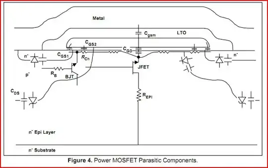

Thermal runaway and second breakdown is a problem with BJTs than MOSFETs don't have, although things can get complicated with stuff like dV/dt failure, and parasitic BJTs in power MOSFETs that can cause unwanted turn on:
ParasiticComp
