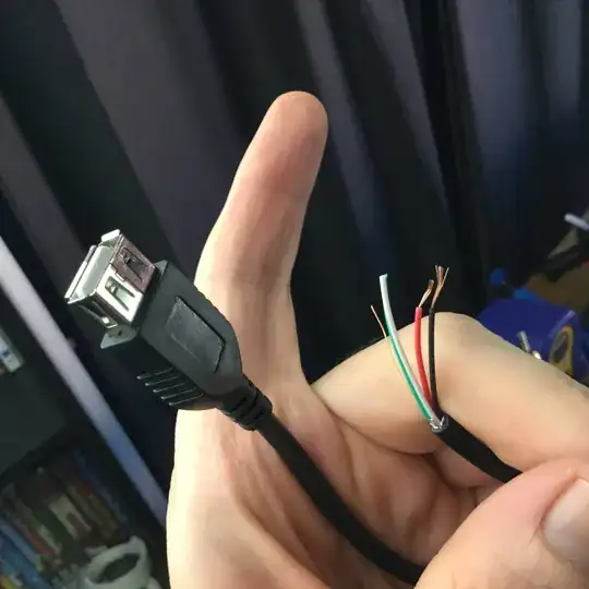

I have looked for a female USB A to power cables but so far haven't found any by a couple search terms. e.g. "usb to pigtails bare wire" UPDATE: I made one using this approach male to female extension, with male cut off, only red and black wires are needed for power which I later tinned and hooked to the powersupply via alligator clips, the data wires I just cut off, i used a sharpie marker to indicate which side is negative on the connector male to female extension cord, with male end, cut off, only outside 2 wires, red and black wires are needed for power
My current best thought is to take a USB extension cable and cut off one of the ends, strip the wires and then either use alligator clips to the power supply OR insert a variable resistor between the power output and the amplifier/transducer.

  • You can just cut off a cheap USB cable and use the two outer wires. Make sure you get the polarity correct. There is no guarantee the device will not immediately fail (be destroyed) if you feed it more than 5.5V or so, nor is it guaranteed to operate at low voltage. – Spehro Pefhany Sep 27 '15 at 01:26
  • @immibis this isn't intended for actual USB computer control, there's no data, it just happens to use the USB for power making the laptop an overgrown wall wart :D – TroyWorks Sep 28 '15 at 17:07
  • @SpehroPefhany thanks that's approach I'm going to use, but I had to order an extension cable with female on one end in order to connect to the male USB. It's $10 so not worried about destroying it, and operating on undervoltage shouldn't really be a killer i don't think as others use/sell variable output voltage supplies with ultrasonic foggers meant for aquariums, fountains, and fogponics. – TroyWorks Sep 28 '15 at 17:10
