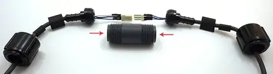

I have come up with an idea for an inexpensive underwater connector system, using PEX swivel adapters, that might be of use to you:
http://edwardmallon.wordpress.com/2015/01/29/a-simple-diy-underwater-connector-system/
Those adapters are rated to 100 psi, so should be good to a reasonable depth. The key is scoring the inside surfaces of the barbs with a wire brush so that the epoxy that seals the barb onto your cable gets some good mechanical adhesion. Be careful not to hurt the oring seats though. I also make sure that the wire insulation does not pass continuously through the epoxy, so that water can not wick down the conductors into the join if you accidentally cut jacket/insulation on the cable.
Links to the parts I am using are in the post, but there are plenty of companies making the parts. I will be testing these guys at depths up to 30m in a couple of months, as part of some new sensor assemblies that I am building. They will be left underwater for several months, but that means I won't have the final word for you on how well they handle long term depth exposure till mid year.

SeaCon is the company we use at work, but at hundreds of dollars per connector in most cases, are probably way out of your league.
That SubConn connector is a lot more than you need as well. It's designed for underwater mating, which I doubt you'll do. You're probably planning on connecting everything up in air and then dunking it in water. Underwater mating connectors also have ridiculously high mating/unmating forces and are rather large.
Given that your max depth is 20 feet, and pressure is about 1/2 PSI per foot, you're looking at 10 PSI. So any connector that can maintain a hard vacuum (14.5 PSI or so) would be feasible.
There's not a huge market for these things (most UUV projects are research or oil exploration related, can afford Seacons or equivalent, run to thousands of PSI of pressure, use pressure-compensated or water-blocked cables, and buy a lot more than you), so most of the products you can afford and that might work will not say anything about pressure resistance.
I'd recommend starting with "harsh environment" connectors. They are usually variants of standard connectors like USB or Ethernet, and have an extra outer shell, screw lock, and an O-ring seal. Be careful with O-rings. It's real easy to pinch one and ruin it if you treat it like a normal connector, and sometimes they need a lubricant/sealant to work well.
You should probably rig up a leak detecting circuit, get a harsh environment connector, put it in 20 ft. of water, and see if it's up to snuff.
