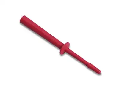

One variant of this is called "shrouded" probes.
These may have covers which are spring loaded and move away or the shroud may stay in position and need the tested point to intrude into the shroud end.
Just what the doctor ordered:
Fused probe bodies with 4mm contact tips. The tip are covered with a spring loaded sheath for added protection. Unscrew the tip to access and replace the fuse. Probe bodies are marked with the rating of the internal fuse.
From Cal Test electronics $14.93.
Materials: Body: Polyamide (Nylon); Contact tip: Brass, Nickel Plt. Banana Contact: BeCu, Nickel Plt. Set available in red and black pair

  • Thank you, Those Cal Test Probes might do the job. I emailed them. I am not sure of their size. They look like regular sized DMM probes and if so I will buy them. – Russ Sep 09 '11 at 22:57
  • I called Cal Test and the first probe that I thought might work I don't think will. They said it was mainly made for HVAC work and not for probing small things. I did order a few of the probes they recommend but they are not exactly what I had in mind. – Russ Sep 28 '11 at 21:45

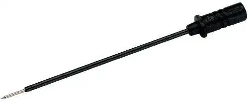

I have some nice small Hirschmann probes:
http://www.conrad.de/ce/de/product/104400
They have rather sharp tips, so they don't tend to slip, but not as sharp as a needle, so it doesn't tend to cause injuries. The tip is spring-loaded, which helps to avoid excessive force.

  • Yes, the sharp tip helps but when I am so concerned about slipping I press the tip into the pin firmly because I don't want it to slip but the pressure I apply seems to contribute to slipping even more if there is a problem holding it down. – Russ Sep 09 '11 at 23:02
  • As I said, they are spring loaded. The 7mm long metallic tip retracts all the way into the colored sheath if you push it, so it's easy to keep the force about right. – starblue Sep 11 '11 at 09:01
  • I did order some probes from Cal-Test that seem to do this. The metal tip retracts back into the probe when pressed down and there is a clear plastic cover that surrounds the tip so you can line it up correctly. I will give them a try to see how they work. Thank you. – Russ Sep 28 '11 at 21:50
